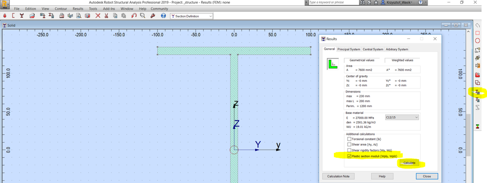

The official website says that the program should indicate the plastic section modulis.
https://help.autodesk.com/view/RSAPRO/2019/ENU/?guid=GUID-867E4938-3469-4703-BD85-55730FA4B477
However I made a parametrical section, I checked all the properties and the plastic section modulis are not indicated. Does anyone know why is that? Did I miss anything or is the program not showing the plastic sections modulis for parametrical sections?

Hi @Anonymous
Help section indicated in your mail refers to Section definition module
While user defined section shape is calculated, plastic properties calculation can be checked
plastic parameters.PNGand then plastic properties are presented in results
If I managed to answer your question(s) press the Accept as Solution button please. This will help other users to find solution(s) much faster. Thank you.
