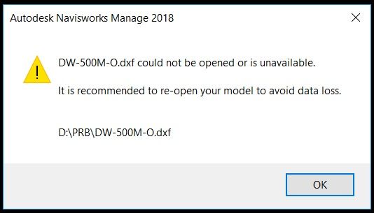

Hi @Anonymous
These dxfs are corrupted.
They can not be opened neither in Autocad, nor Revit, nor Robot, nor Navisworks
