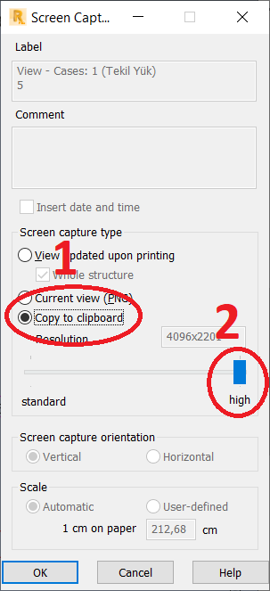

The easiest way is choosing: Copy to clipboard and then paste it in Paint.
Muhammed Mamdouh (OPERA)
Structural Engineer, Instructor
Facebook |LinkedIn
I found new way to HD screenshot.
First use Screen Capture Tool
Then open Microsoft Paint and just paste it.
