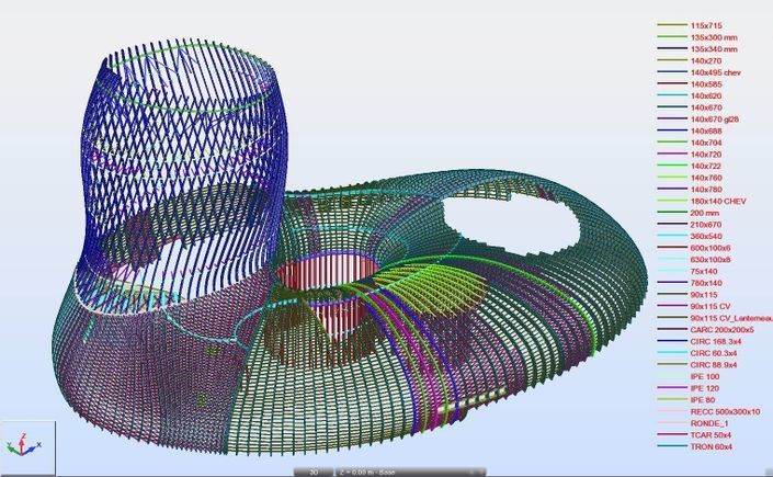

As suggested I'm starting a new topic intended to show what you dear Robot users achieved with little help of RSA Smiley Happy
Courtessy of @Rafacascudo
