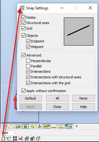

Rafacascudo
well , in 16 years ,it is the 1st time I see an error like this.  These kind of mistake happens when you set the vetor through mouse snaps. It´s very easy to snap to  some of these below as they are already activated by default.
I would say that it is nearly impossible to be a RSA bug.
Can you reproduce this error again?
Maybe official support has other ideas of how this happenned
Rafael Medeiros

Hi @Anonymous
As the definition of released d.o.fs in rigid links refers to the global coordinate system in situations when you are working in other planes the best option seems to be replacing them with rigid bars with gamma angle defined in such a way that their local axes correspond to the 'directions' you want to release and define releases in their 'slave' nodes.
For the crashes: have you sent any crash reports?
For the snapping: make sure you switched off the display of the grid when you indicate the translation vector.
I  hope this helps.
