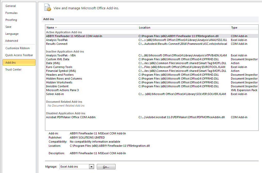

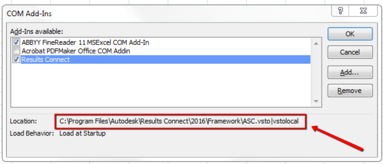

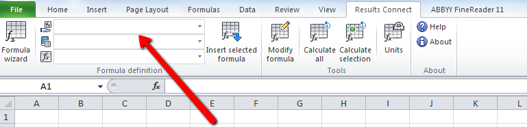

stosto6666
I still have problems with Results connect running on my Excel (x32 v.2010).... Please see the screen captures attached. Thanks
Message 14 of 23
stosto6666
I can't see the file which I needed in the Excel add-ins, please see next picture...Please help!!!

Rafal.Gaweda
Autodesk Support
Autodesk Support
Delete everything from:
c:\Users\%USERNAME%\AppData\Roaming\Autodesk\Results Connect\2016\
replaces files in
c:\Program Files\Autodesk\Results Connect\2016\Framework\Configuration\
by the ones from attached zip
Rafal Gaweda
Message 18 of 23
stosto6666
Thanks Rafal, Your solution solved the problem!
