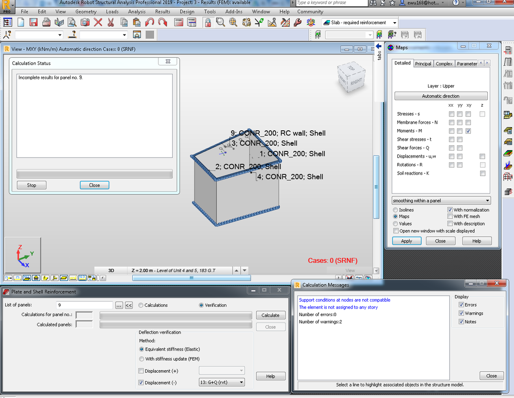

ewu168
Hi Artur,
please take a look at this model, the Required Reinforcement or Minimum Reinforcement is no working and showing zero result to all panels,
looking forward to your prompt reply,
Regards

ewu168
Thanks for your reply,
I've tried but it doesn't work on my model, all the function grey out...

ewu168
I have set according to your instruction, but never succeed,
would you mind to try and set it in that model? if you run it you would get the same result,
or if you have a successful model, it would be great if you could get me share it, as no matter what I do it seems ARS is not able to run reinforcement calculation to Australia code properly!

Message 9 of 9
ewu168
Thank you, it is working properly now after I created a new "Plate/Shell Reinforcement Type". see attached below.
It seems the original default setting wasn't working, but anyway, thank you for your kind help:)
