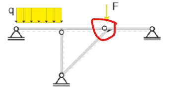

Hi everyone! I just wanted to ask, how can I draw this type of connection in beams(see the attachment)? Thank you in advance Screenshot 2022-12-28 153915.png

Stephane.kapetanovic
hi @khalid.aliev
it seems that there are two symbols (embedded and articulated) in the same place.
the articulation seems to be on the horizontal beam (B4 N3), the embedding on the strut (B2) with the rest of the beam (B3) up to the support. Ask the sender for confirmation.
Best Regards
Stéphane Kapetanovic
