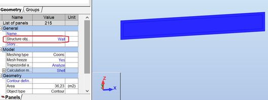

Hi @saclovitzky
In jour model, change structure object to « wall »
In <job preferences> as provided reinforcement for wall is not implemented BS code in Robot, change it to French code "BAEL.
In these sceenshots below Look at values equivalences
Provided Wall reinforcement takes into account tension and compression in the wall
A small example  and you updated model are attached

Message 6 updated:
You said:
He said that how is ARSAP take into consideration the uplift force,in terms of providing reinforcement.
Provided reinforcement is calculated taking into account tesion and compression as yo can see in Reinforcement parameters applied to the walls.
M. Agayr
