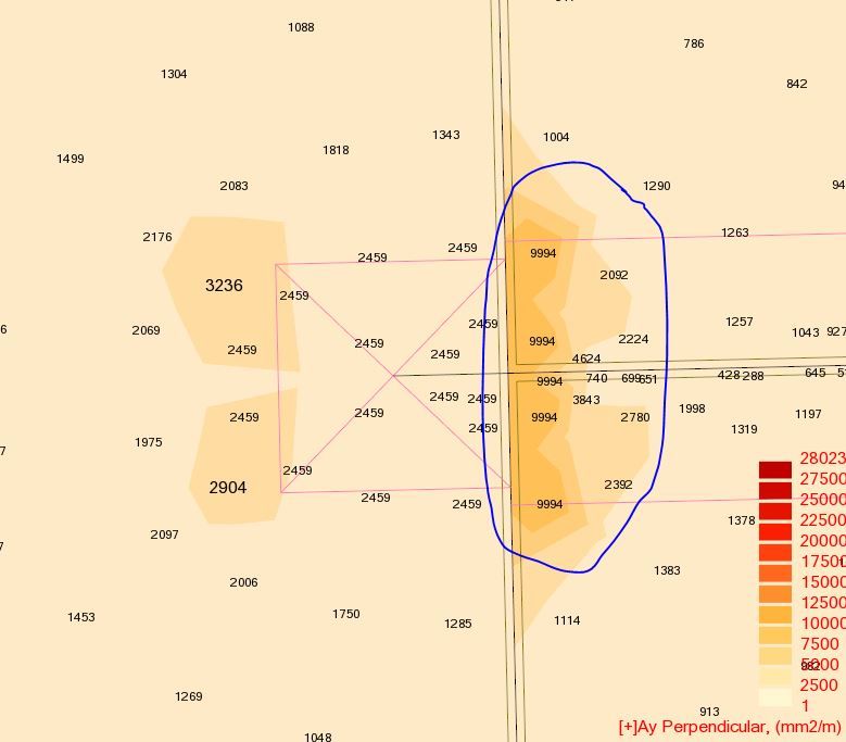

Hi, Anyone has an idea why on a connection of two slab elements I have high required reinforcement on one side of the connection even moment diagram doesn't show any abnormalities in this area?Capture1.JPGCapture2.JPG

Could you please attach your model?

Is it  the same when you disable correction of deflection by additional reinforcement (if activated) and the reduction  of the moments over supports?

Artur, this was due to redistribution of loads from one panel 400 mm deep to other panel 250 mm deep (Globally averaged design forces). Without redistribution the maximum bending moment stays in the slab with bigger depth and therefore OK e.g. there is no excessive amount of reinforcement on one side of edge after redistribution has been switched off.
