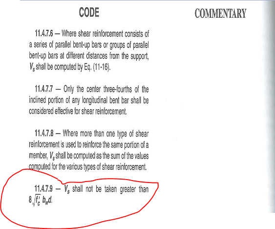

I'm sorry for not answering earlier but I wanted to run test on SP4 for RSA 2016 before posting the answer on the forum:
1. Too small cross section error displayed on frozen reinforcement when you delete pins is no longer displayed on 2016SP4 which corresponds to me assumption of it being excessive as there is no such error displayed when you run calculations with such reinforcement after freezing it.
2. No difference in the shear capacity diagram after deleting pins is due to the limit from point 11.4.7.9 of ACI
3. For the requirement of having all main rebars tied - could you attach the content of point 7.10.5.3 of ACI 318 please? Does it say that every main rebar should be tied or every second main rebar should be tied? Thank you.
Artur Kosakowski

2- The thing about Vc I am not getting is the following:
In ACI 11.4.7.2 it is stated that:
Where Av corresponds to the area of transversal reinforcement. In this case, the diameter of stirrups I am using is #3 and the spacing in the confinement zone is 5 cm.
Also, the number of vertical bars on the section must be taken in account for the calculation of Av.
Evaluating all this variables, we can obtain the following result:
Vs= (#vertical bars * Av * fy * d)/ s
If we put the third pin in the section as robot is doing automatically, the Vs shall be:
Vs= (3* 0.71 * 4282 * (40-5) ) / 5 = 63844 Kg
If we remove the thrid pin:
Vs= (2 * 0.71 * 4282 * (40-5) ) / 5= 42.563 Kg
Also applying the 11.4.7.9 we have
Vsmax= 2.2 * (250)^0.5 * 30 * (40 -5 )= 36.524 Kg
So this means that the 32.000 robot is showing in the results is the 36.000 I am calculating?
Also, the software calculates a Vs inferior to 36.524 Kg in the center of the span.
3- The code 10.5.3 is refering to compresion members, we are currently evaluating the beam shear design. This beam is not presenting any axial force.

Message 20 of 37
Also, to clarify even more what the article 7.10.5.3 is saying I took the time to draw this:
(Warning: I am not an artist)
The considerations of 7.10.5.3 are stated for compression members.
For flexural members (beams) this are the ones that ACI states:
