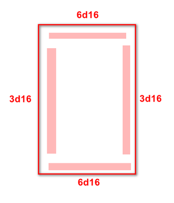

I have question about required reinforcement in cross section of RC column. In RSA are results from analyze for required reinforcement like this:
 In Autodesk web manuals for RC reinforcement I found this:
Now I would like to make reinforcement drawing according to the my calculation, but I have a concern about reinforcement quantity in cross section...
What is correct? Left or right choice, picture under:
Thank you for answer. Regards!

Hi @Cestakar
Left one

Hi @Cestakar ,
Actually, you didn't sketch the right pattern.

Simau
Hi @Romanich
Do you mean this

Cestakar
If I right understand the upper answers, are RSA results for required reinforcement only for one side of B and H in the column cross section? So I must in the column cross section provide min. doble of required reinforcement (2x of results)?

@Cestakar , according to your results:
