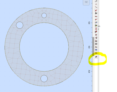

I am trying to find provided reinforcement for a hollow core circular mat foundation.
I can calculate the required reinforcement area(+x,+y.-x,-y) but when I switch the the provided reinforcement there is nothing on the screen that I interact with. I am not sure this is expected behaviour or software bug.
I am attaching the screenshots of the model.
Kindly provide support if possible.

Hi @umut.akparlar
To transfer slab to provided reinforcement modle
select slab
open Design >Provided reinforcement of RC elements.
 Refer to
RC Design - workflows slabs, walls and wall foundations design
Keep in mind that RC slab provided reinforcement generates only ortogonal reinforcement.
