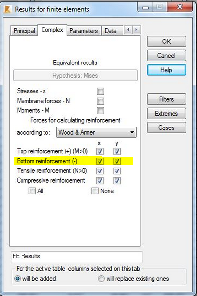

The Robot sign convention is for positive moment to cause tension in upper face. But the help file related to wood-armer design suggests that positive moment causes tension in the lower face.
When Robot calculates the Wood-Armer moments and forces which of these conventions is actually applied?
Snapshots of the two dialogues are shown.

Thank you for spotting this. In this part of Help the lower ones should be negative and the upper ones positive
as in the dialog where this information is shown correctly:
