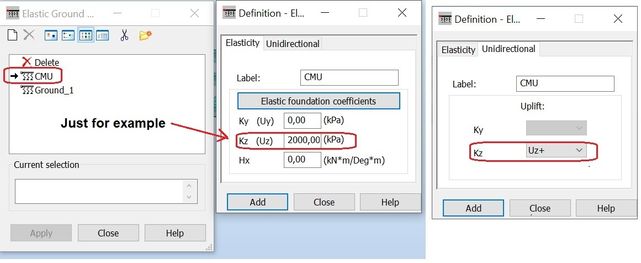

Simau
Hi @HoshangMustafa
I will instead model the CMU with elastic ground.
It is necessary to estimate the vertical stiffness of this wall

HoshangMustafa
Hi @Simau
How CMU (concrete masonry unit) could be modeled with elastic ground (soil coefficient)?
How would you estimate the vertical stiffness (membrane stiffness) of this wall?

Simau
@HoshangMustafa
Robot 2019 is no longer installed here.
Here are some screenshots of the model.
To estimate the vertical stifness, model the CMU with a storey height a, its dimensions and  its material characteristics .
Apply a unit effort N and look at the displacement d.
Kz= N/d
M. Agayr
