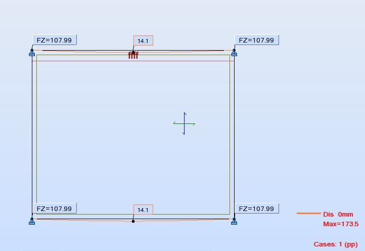

I am modelling vertical panels in a structure only to transfer loads vertical (self-weigth of partitions). I want the loads to be transfered to the beams below the partition, but it happens that the load is transfered to the beam above (it is hanged) and the beam below (half and half). Is there any way for the wall to transfer the loads only to the beam below.
Thanks.

Message 4 of 12
Here you can see it.

Rafacascudo
If it´s just to transfer vertical loads , why not just directly load the beams with distributed uniform load?
Anyway , If it´s just one wall ( bottom and top beam) , you can set it to load only the bottom beam
This will not work if there are several floors ,as the top beam will be the bottom beam of the upper wall.
Another option would be making the cladding contour just a little short as to not reach the top beam. For examble instead of 5m height it would be 4,995 m .
and don´t forget to set one way load distribution (vertical up-down)

The model has several floors, so I would have to use the second solution.
The point of modelling the panels instead of loads, is because I am analyzing the global behaviour of the model comparing structural walls or partitions. So I wanted to change claddings to shells easily.
