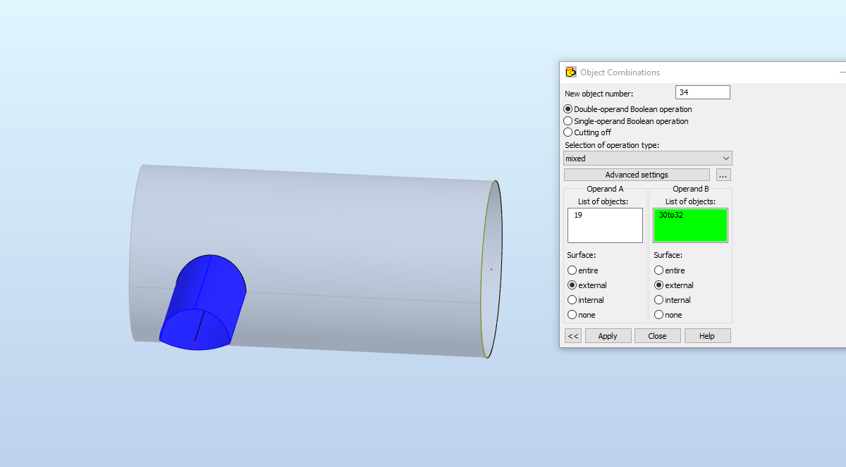

I am trying to combine a series of panels representing 2 tunnels intersecting perpendicular with each other. One tunnel I have defined with a circular polyline and the extrusion tool, creating one panel. The other tunnel I have defined with 3 arcs and similarly used the extrusion tool, creating 3 panels. See "Base Model" png attached.
I have tried to intersect them by using the "Object Combinations" tool in the Edit Menu. For that I have used the "Double-operand Boolean operation", with a mixed operation type, using the first tunnel (1 panel) as Operand A and the 2nd tunnel (3 panels) as Operand B. The surface I set to external for both. See "Objects Combinations Options" png attached.
However, when doing this, I have noticed that a "triangle" of tunnel remains for the first tunnel within the boundaries of the second tunnel, which is obviously not correct. Accordingly when meshing Robot is trying to mesh this bit too. See "Objects Combined" png attached.

The snips to illustrate my case are below:
Base ModelBase Model
Objects Combinations OptionsObjects Combinations Options
Objects CombinedObjects Combined
MeshMesh

I have prepared video how mode can be meshed. Short description of modification steps
  • Setting solid modeler in Job Preferences
  • Copying your object to remove combination operations
  • Object union (to get one object)
  • Meshing
  • Unnecessary finite element deleting
  • Unnecessary nodes deleting
  • Modification of object sides local system of coordinated (all Z axis outside of structure)
  • Thickness definition
  • Support definition
  • Calculation
Attached you will find modified model and link to video presentation
