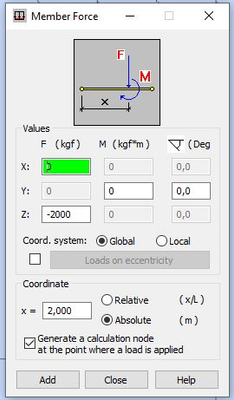

Hi everyone,
I applyied OFFSETs to both ends to a beam and realized that the Concentrated loads applyied directly to it moves to a different position. See figure bellow.
Is it that the way the OFFSET command is supposed to work?
See bellow the way the load was applied to the beam.
234 Views
1 Reply
Reply (1)
Rafacascudo
Yes, it is correct, if the bar changes its effective ends through offsets , bar loads will follow.
But you can apply the load directly to node 20 instead.
