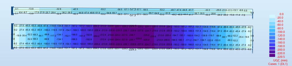

If you mean as "works together" that the angles will transmit the force to the bottom plate by contact only , I am afraid that this will never happen . The difference in stiffness between a single angle and the 2mm plate is huge.
See the difference in vertical displacement just for the self weight.
Difference is around 400x . This means that the load to make the angle touch the bottom plate displaced only by self weight would have to be huge.
Even that analysis converged for your loads/combinations, results would never show the angles transmitting forces to the bottom plate.
