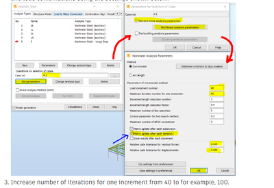

I've been working on the model of a portal frame, and I had set up my bracings as tension-compression members, so it's being calculated as a nonlinear analysis. I am coming across 'no convergence issues'. I tried a few things as outlined on this page but without success ("No convergence of nonlinear problem" during analysis in Robot Structural Analysis (autodesk.com)

- you have used compressed only members for bracings - used sectiopn types (angles) suggest that your intention was using tension only members for bracings (correct me if I have missed your idea). I would change bracings to tension only members.
-you are using default setting/parameters for nonlinear load cases. I would suggest activation Matrix update after each iteration setting as described in Non convergence.......-article
For bracings changed to tension only members and modified parameters of nonlinear cases  model converges for all load cases.

Related to the parameters for the analysis, I added automatic calculations (manual calculations - generated) and I am getting the same convergence error. My question is, can I set up the parameters for nonlinear combinations as well? It would this interfere with the results?

You can set calculation parameters for arbitrary load case/combination number. Type all for all load cases in Case list
