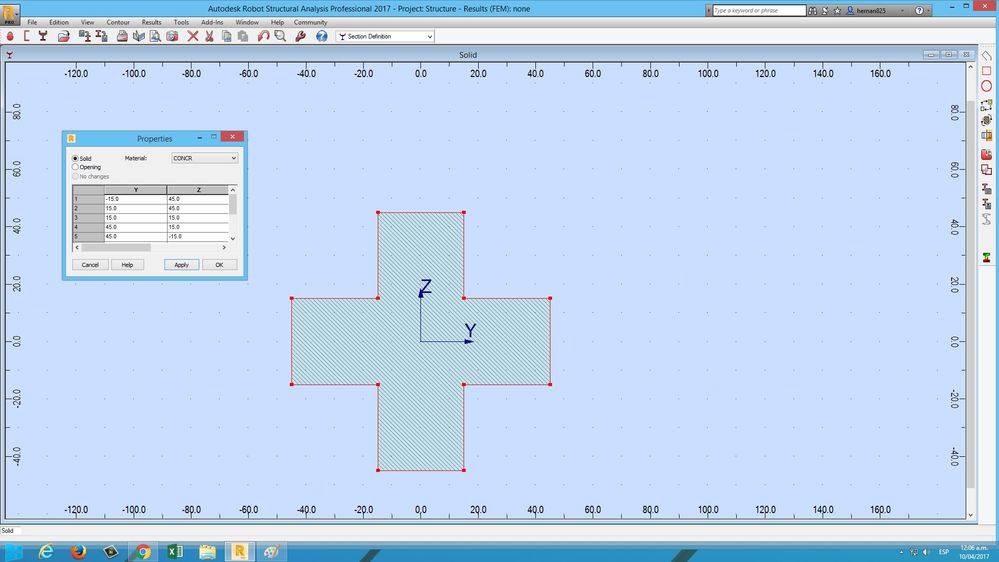

tengo esta seccion tipo cruz, de concreto que quiero añadir a la libreria, como lo hago?

You can save it as if it was a steel section and then change the material of a bar which you assigned to this section to in a model from steel to concrete. Mind that it can only be used for static analysis of a structure and you will not be able to design its reinforcement in Robot.
