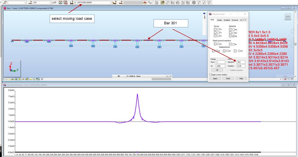

Sorry to dredge up an old thread but is it possible to get the influence line report for a bridge with different sections? i.e. A Varied deck box girder bridge?
Kindly find attached my model as I would love to generate the influence line results for the entire bridge for a calculation report.
@Rafacascudo
Rafacascudo
It doesn´t matter what kind of bar you have on your model . Just select the the moving load and goto Results/advanced/Influence line... and,,,
If you want the "classic"  influence line by  an Unitary moving load ,then you have to create a new moving load case with a new unitary vehicle
Rafael Medeiros
CivilYoke
Thank you so much for taking the time engineer. I was looking for a way to show in the calculation notes that the influence line analysis for the bridge had been performed, but as you can see, the deck is a combination of various members. My question is "How can I show this in the calculation report to be submitted to the checking engineer?
if the bridge was made up of just one bar, the influence line results would be easy but since it doesn't, do I have to select every single section bar that gives a critical value (i.e. shear, moments etc)?
Thank you in advance.
Rafacascudo
    If this bridge was made by just one bar , you would have the same work to extract influence lines for each position along this bar. I do not see the meaning of checking the influence lines for this type of bridge as they are just continuous well behaved and apparently symetric spans . One useful information to extract from the influence lines would be where to load the live moving load around the vehicle, but even for this ,it is pretty obvious and simple to know where to put the live load to obtain max/min inernal forces/reactions/displacements.
   What the checking engineer probably wants, regarding moving loads ,are the envelope diagrams for each meaningful internal forces , reactions and displacements ,like the one below
