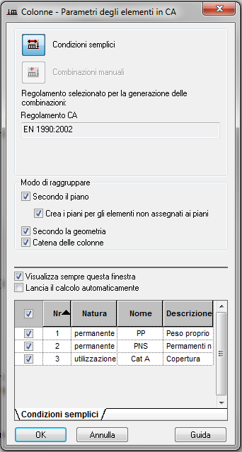

Doing some test starting from beta version I noticed a different behavior of the real reinforcement module related to the regulation used.
In job preferences you can select simultaneously different regulations. For example, you can use the NTC2008 for seismic and loads combinations and the Eurocodes for the calculation of real reinforcement. The module for real reinforcement seems to create from scratch load combinations starting from simple load conditions. It is not clear which is the regulation is used in this operation.
The dialog box that appears at the beginning is rather obscure. Regulation used for real reinforcement calculation is not clearly indicated.
The real reinforcement uses the regulation selected in job preferences for loads combinations or the regulation selected for the design of concrete structures ?
if you select NTC2008 for combinations of loads and EN 1992-1-1:2004 AC:2008 for the design of concrete elements Robot seem to take the second one in order to create load combinations.
Using real reinforcement module the initial dialog box looks like:

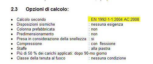

In this case It seems that the regulation used for the calculation of load combination is Eurocode. In the printout of the real reinforcement calculus you can find the following information:
From NTC2008 (or Italian) point of view this in wrong because that loads combinations appears incorrect:

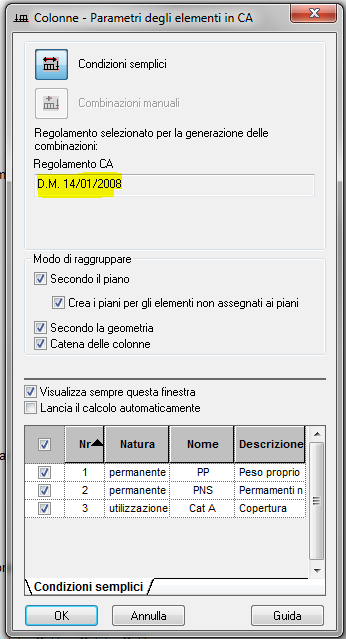

If you select NTC2008 for combinations of loads and EN 1992-1-1 plus Italian NAD  for the design of real reinforcement of concrete elements the situation changes.
The dialog box informs you that the regulation that have been used is NTC2008
load combinations created in the real reinforcement module seems coherent with NTC2008
It's just a coincidence or you can use a sort of mixed regulation?.

The RC design modules generate its own code combinations based on the regulation that corresponds to the selected RC design code. The reason is that these modules are also accessible in the stand alone modes where there are no structures to import results of static analysis from but they have to be calculated based on loads defined inside of each of the design module itself. The other issue is that some of these modules (e.g. Spread footing) require additional set of combinations to be generated e.g. for geotechnical part of the design. In case you want to use exactly the same automatic combinations you generated for the model of the structure according to the selected regulation (e.g. when different that the one that corresponds directly to selected RC design code) you should convert them into manual combinations and then use such created manual combinations for the design in the RC design modules of Robot instead. The conversion of automatic code combinations into manual combinations can easily be done in the combination table (being on the values tab select  all table using CTR+A and pres the right mouse button, then select Code combinations -> Combinations) and then all you have to do is to import manual combinations rather than simple cases.

The problem is that these modules behave differently using NTC 2008 + EN 1992-1-1:2004 AC: 2008 (oops DM 14/01/2008 :smileywink:) or DM 14/01/2008 EN 1992-1-1 Italian NAD.
In the first case the EN 1992-1-1 is indicated as regulation for loads combinations, in the second case is indicated the DM 14/01/2008.
The question quite obvious.
In the first case seems that robot uses the coefficients of the Eurocodes in the second case it seems that those uses the DM 14/01/2008 ones. .....The question is more general.

I will try to explain in the best way I'm able to. First of all you can combine them but you should convert automatic code combinations into manual combinations and use these manual combinations for the design rather than import simple cases designing RC elements. As you know there are by far more load combination regulations than RC design codes in Robot and it is e.g. possible that you can use the one that is intended for steel structures in the model rather than the one intended for the concrete design (or use the one that is entirely 'different' than the one 'compatible' with available RC design codes in Robot). A quick example is e.g. a project you have for the US. You have a mixed structure and you want to design steel part using LRFD and concrete part using ACI codes. What you do is you generate code combinations for LRFD in the model and use them for steel code checking and then you import simple load cases onto the RC design modules which combines them using ACI regulation that is internally linked with selected ACI concrete design code. If the module uses LRFD combinations from the model they would be wrong for the RC design. In such a way we 'try' to avoid the situation that the user generates code combinations according to the rules that are not 'in line' with RC design code set for RC elements design without being aware of this fact. Finally the stand alone module and elements imported from the model should be designed in the same way - what I mean is that if simple load cases are defined in stand alone mode and the same load cases are defined in the model (I mean loads to be exact) the design should produce the same results.

This is what is actually done. If you decide to import simple cases then the RC Design module will automatically generate combinations which are then used for the design of the particular elements such as columns, beams etc. In other words regardless of the code combination regulation you selected in Job Preferences for the model, the selection of RC design code will govern the rules for generation of combinations inside the RC design modules (e.g. if you select EC2 code then combinations used for design of RC elements will be based on Eurocode rules, if you select ACI as your concrete design code the simple cases will be combined according to ACI rules). The only exception is the RC Slab reinforcement module that uses directly code combinations from the model.
In case you base your design on manual combinations then all RC design modules use them directly for calculations of reinforcement.
