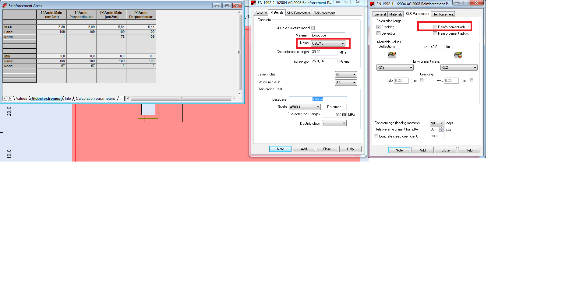

I cant understand the robot values of min reinforcement, probably I am doing something wrong..
Input: Concrete slab t=400mm, C35/45, reinforcment bars A500HW (bars, predefined in robot diam. 12mm). Upper layer is XD3, what means concrete cover of 45mm+10mm, bottom layer is XC2 with 25+10mm cover.
Output in Robot: if i uncheck the cracking reinforcement adjust then I get similar results (but not exact) with hand calculation ~4,6cm2 (Robot) vs 5,64cm2 (hand calc). If i put it in (reinforcement adjust), then Robot show me 8,5cm2 for 12mm bar and ~10cm2 for 16mm bar!!!
My hand calculation:
EC 1992-1-1 p.9.2.1.1 (1) As,min=0,0013*bt*d=0,0013*1000*339=441mm2 or 4,4cm2.
EC 1992-1-1 p.9.2.1.1 (1) As,min=0,26*fctm/fyk*bt*d=0,26*3,2/500*1000*339=564mm2 or 5,64cm2.
EC 1992-1-1 p7.3.2. (7.1) As, min=kc*k*fct,eff*Act/fyk=0,4*1*3,2*200*1000/500=512mm2 or 5,12cm2.
Firstly, it looks that Robot doesnt take As,min=0,26*fctm/fyk*bt*d, but only takes As,min=0,0013*bt*d (if reinforcement adjust is unchecked), but is first expression gives bigger value it should go in.
Secondly, As, min=kc*k*fct,eff*Act/fyk doesnt go with hand calculation.
Can anybode comment this?

Set the concrete grade from as in the model to C35/40. As far as I can see the change of some parameters in the label reset it from as in the model to C20/25 which then changes fctm in the formulas you referred to. We will investigate why this happens.

We spoke in different languages 🙂
I agree that with this setting Robot calculates minimum amount of reinforcement right.
But if you take SLS conditions into account the result should be (by my hand calculation) 5,12cm2 by 7.3.2 (2) or 5,64cm2 by 9.2.1.1 (if Robot pick bigger value into account) and in my file with SLS condition As,min is 8,5 cm2. I cant understand why its not around 5,12...5,64? My hand calculation are wrong or something wrong in my ARSA2013
σs is the absolute value of the maximum stress permitted in the reinforcement
immediately after formation of the crack. This may be taken as the yield strength
of the reinforcement, fyk. A lower value may, however, be needed to satisfy the
crack width limits according to the maximum bar size or spacing (see 7.3.3 (2))
According to the table from this point Robot assumes 280 instead of 500.

Thanks Artur, now its clear.

 But my second question is still unanswered, my hand calculation of As,min by 7.3.2 (2) dont go with Robot ones.
Agree with Robot upgrading, we will take it in near future :smileyhappy:
Corrected in SP1 for Robot 2016.
