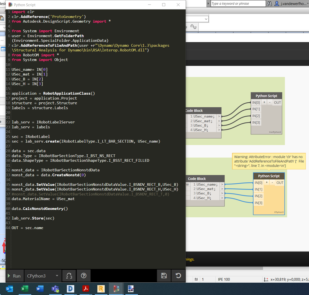

but the problem which occurs is that i wrote a lot of python scripts inside the .dyn files. and these when i open the script wil run on 'ironpython2' and dynamo gives the message that i have to migrate to 'Cpython3'.
"Python Migraton"
This graph currently contains nodes that are using the old IronPython2 (Python 2) engine which will be deprecated in later versions. A new CPython3 (Python 3) has been implemented and is accessible inside the Python editor.
This is my old script which runs perfect with dynamo studio. and with dynamo add-on on RSA 2022(set to ironpython2)

this is the dynamo graph
this is the migration message
as you can see the ironpython2 works but the Cpython3  not.
the code inside Cpython3 is still the same as the code above. but i get this error message:
So my question is: did i miss something beceause dynamo is now an add-on or is there something else wrong.
please help me with this.

Message 2 of 12
JacquesGaudin
Assuming that the new CPython 3 is using PythonNet (which would be great news IMO), you need to replace ``clr.AddReferenceToFileAndPath(<your path here>)" for "clr.AddReference(<your path here>)". Try that, chances are it will work.

Message 4 of 12
1234eddie
@JacquesGaudin @okapawal thanks for your reactions so far.
i followed the description from @JacquesGaudin
step 1 work fine(changing the 'addreferencetofileandpath' to 'addreference'.
but then i get this error
changed the c from create to a capital. (works. next error occurs)
so changed data into this:
and now i losed my mind in this. because this is what's in the API SDK tutorial.
that's the source i use. So i don't get the point why i have to change these parts described above. I Hope someone of you can explain this to me so that i can solve my scripts easy.
(because i have some script over more than 500 lines)
thanks in advance.
Message 5 of 12
JacquesGaudin
The type inference with CPython works a bit differently to what IronPython is doing.
When you do ``sec = lab_serv.Create(...)`` you get a generic COM object that doesn't provide any interface.
If you cast the object to the correct interface, you can start using it, like so:
``sec = IRobotLabel(lab_serv.Create(...))``
You'll get this issue a lot. I wrote my scripts with CPython and PythonNet so got used to it. Clearly in your case, you want it to be part of a migration script.
On another note, you don't need to assign the type to a variable before assigning a value in Python. So for example in:
sec = IRobotLabel
The first line can be omitted altogether, I just assigns a value that gets overwritten in the next line.
