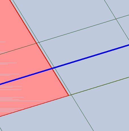

When i finished the modeling .. there's problem with mesh .. i tried to edit element size and also tried as recommend or forced .. it's not work .. also when i used moving load .. i assign load and path correctly all of thing right .. but i want to know how i apear moment changes with moving load applied
Here the link http://www.filemail.com/d/digsxkmytjzgizo

Why have you created panels edges 1cm from solid FEs lines ?
Correct panels.

okay .. i apply slab on the whole structure as one unit .. also the problem is found ... by the way i also delete the path of moving load .. i don't know why the nodes flocked around

MUHANNAD.ABU_ABDO
Did you see this ... that's th problem i correct it but that's what i can do .. plz help me

File please

file is here eng.rafal
http://www.filemail.com/d/tshsaonuucqhnnm

Why have you left main girders bars 1cm or 3 cm from solid FEs edges ?
Corrected file : http://we.tl/aJiYjkxGdq

that's becasue i apply nodes and relate them by bars .. many thanks eng.rafal you teach me every time .. i'm grateful to you
