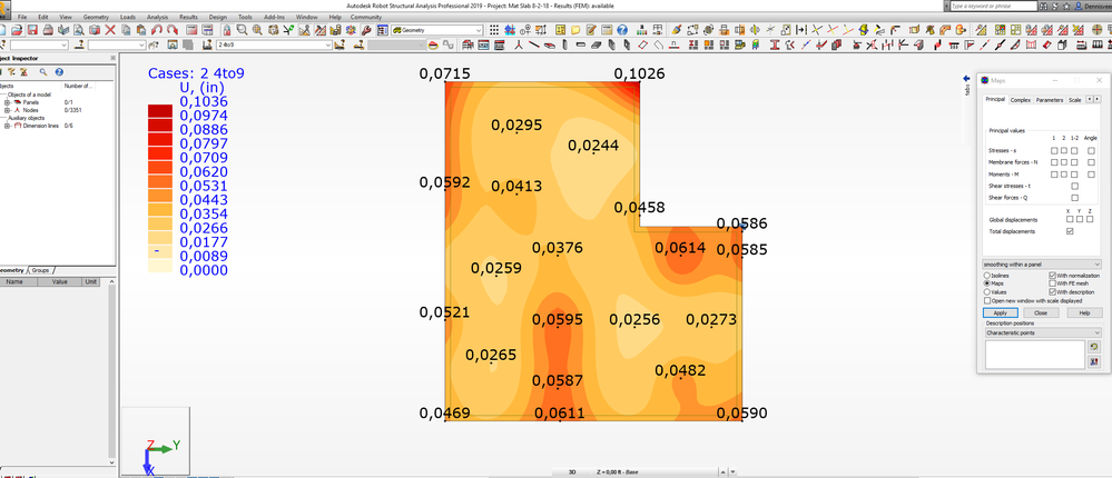

Being a little green I am unsure of the accuracy of my mat slab/raft foundation model.
It would be fantastic if a savvy user would be willing to look it over to insure that the modeling appears correct and that it is at least creating the correct "Required Reinforcement" output.
Thanks in advance.

Hi Artur,
thanks for taking the time to respond.
It is a very simple residence mat slab supported on Kz soil, the slab has a series DL and LL loads.
I would greatly appreciate a review to insure that I have modeled the following correctly:
- Kz support of the slab.
- Slab Reinforcing parameters for Area of required reinforcing output.
- and correct FE mesh choice.
Thanks again.

Hi @pncad250
If you expect uplift for any part of the panel change the soil to unidirectional (uplift UZ+ in the soil parameters of the panel thickness). This requires changing the model type to a shell first (Geometry > Structure type > silo)
Switch off deflection calculations and check panel displacements instead (KZ will govern this)
If making it denser will not change the results beyond the limit you decide on (e.g. 3%) it is OK.
In addition there is no load defined in case 3.
If I managed to answer your question(s) press the Accept as Solution button please. This will help other users to find solution(s) much faster. Thank you.

If looked at you model, see fine to me. two points you can look into:
[1] mesh size, start with the thickness of your slab,
[2] use coons, with recteangels for rectangular slab shapes, see below:
screen3.PNGmaybe your support spring Kz is high, try 1/3 of your current Kz value for a lower bound.
keep up the good work.
Cheers!

Ignore the stability warning, type 3 can be ignored if the displacement is what you expected.
Your displacement looks fine to me:
