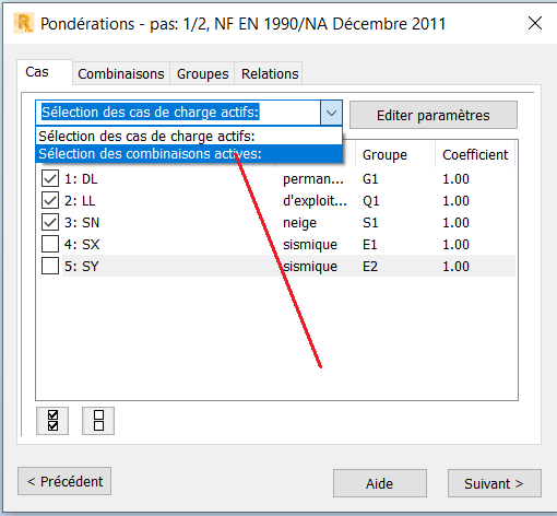

I am doing a project where I was given the seismic horizontal load. I have used linear load on edges to simulate the seismic actions. (See the attached document for screenshot). I have made one load case for X-direction and one for Y-direction. I want to use automatic combination so that Robot can generate load combinations for ULS, SLS and ACC:SEI. My goal for the ACC:SEI load combination is to get combinations on the form like this: 1*X + 0,3*Y +0,3*Live +0,2*Snow
I have tried many things, but I haven`t been able to do this when I create a manual seismic load case.
After trying many different load combinations and cases, I noticed that the automatic load case generator made excessive load case groups (Se the attached document). How do I get rid of load group EI, E2, E3 & E5?

Hi @nilsarne
Before using automatic combination, create Newmark combinations then run automatic comb:
Select Newmark comb you create before
When you generate the comb, you'll get what you are looking for

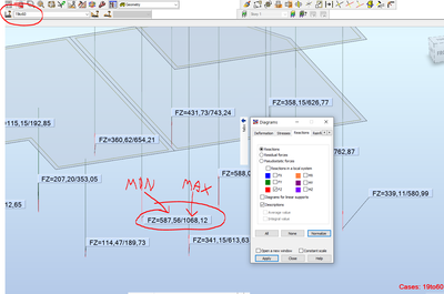

Q4: Why do you prefer making "manual combinations - generate" instead of the "full automatic combinations." How do you check ULS+ for bending moments, normal forces, deformation etc when making manual combinations? Do you first select the components as shown below, then Robot automatically give you the max and min value?
Q5: If I want to delete these "manual combinations", how do I do this? And if I make some changes to these load cases, will the combinations automatically update? I dont need to first delete them and then make new ones for the changes to take place?

Q1:
Yes you are right, but here we have only 1 wind and 1 snow load case so (or) and (or excl) will give same result.
Q2:
No quick way, manually
Q3:
Want only a confirmation from your side.
Q4:
Only my preference, because i want to check combination generated, so i could delete trivial comb i don't need before running generation, and saving calculation time.
Q5:
See attached screenshot
Yes
M. Agayr
