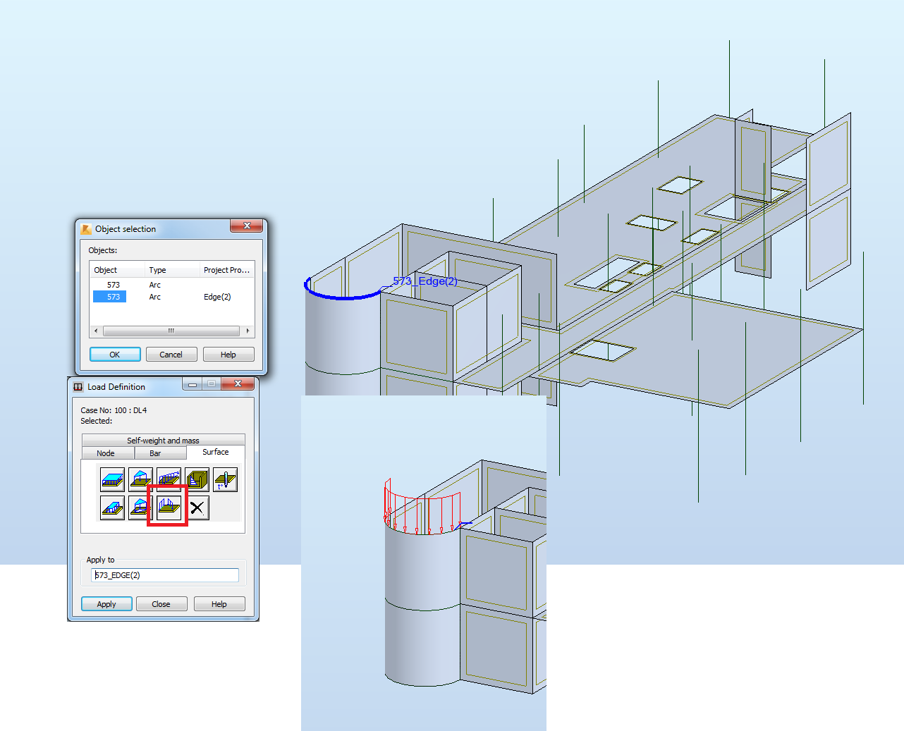

Hi
I am wondering if it is possible to add a line load on the arc?
Tina

Yes, in exactly trhe same way as for any other panel edge:
