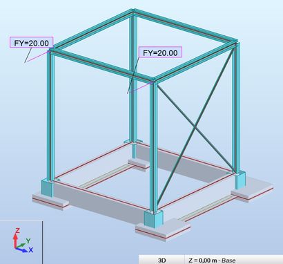

Hi, it is really common here to design for industrial buildings isolated foundations that are connected with tie beam foundations as it is shown at the attached file. How can I design this type of foundation using Robot?

Personnally i will not bother with these ties. They are constructif elements that retain the soil at both sides. More over it's conservatif.
To design your foudations use directly the model you attached

The problem is that we want to take tie beam in to account in order to minimize the dimensions of foundation. The foundation that is designed from Robot without tie beams is huge.

You may add the ties with the existing offset using rigid links.
Model attached
Let us know the gain brought by the ties

At the model that you attached, the tie beam doesn't have any support (like elastic ground), nor is a foundation designed. Finally, at my foreamentioned drawing, the tie beam is a T beam section.
My problem is how I will take in to account the reliefing of the foundation from the existing of the tie beam. So, my question is how we can model a combined foundation system with tie beam AND isolated foundation, which is a common practice to several european countries.

You may add panels at the existing model.
It's more difficult to take into account the ties offset, and i think it's not so different if you assume that there is no ties offset.
In the model attached i tried with tie offset but to much time consuming. So i let you choose what you prefer.
Keep in mind that if you allow uplift in foundation elasticity parameter, you will not be able to run modal analysis

I don't know what Cype can do in this particular case, waht i can say is with robot there is no ready-to-use solution.
The flexibility of robot allows you to model any structure, you just have to put the time it takes. I gave you a workaround from many other to solve your problem, it's up to you to ask and put the time it takes.
It's not so difficult to add panels as foundation to your actual structure. You will get all results as: soil stress, founadtion uplift, foundation reinforcement,....
