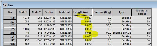

Such request may be impossible to be fulfilled when the instability is due to the large difference of stiffness of elements (e.g. short vs very long bars). Try to select all the model and intersect the bars (Edit > Intersect). Then look at the shortest bar and try to eliminate them from the original model by moving their nodes (merging them).
