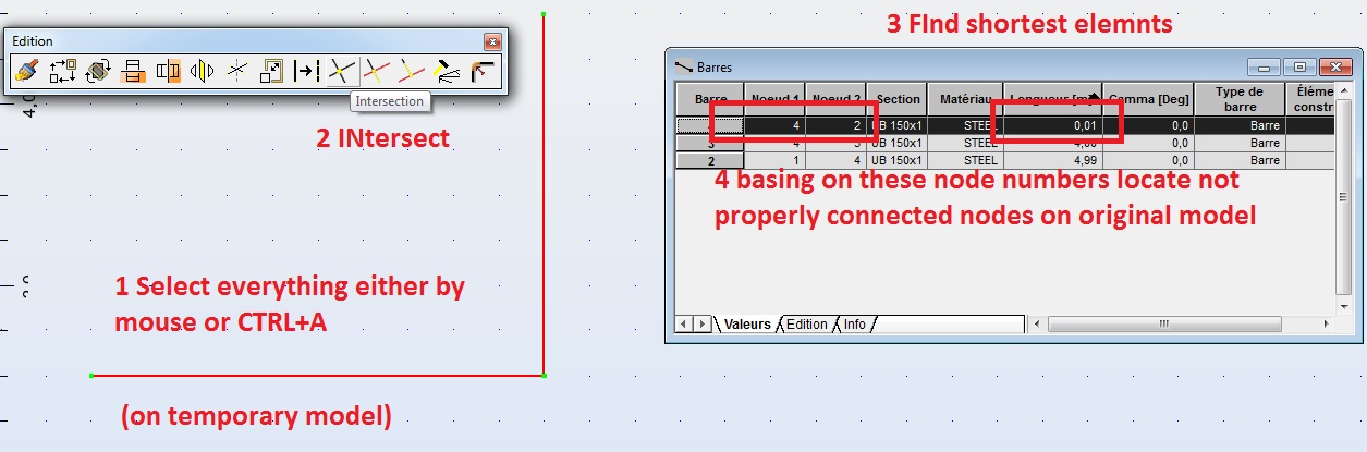

if the difference between these values is greater than 1e11 \ 1e12 program reports instability number 3.
It is related to big differences in stiffenes of elements for example very short elements exist in model = some inaccuracies.
You can check it this way: on dummy model select everything, make intersection, then open Bars table on View tab. Find shortests bars. Then locate nodes \ places on original model and correct location of nodes.

Rafal.Gaweda
in reply to: Anonymous
Example below
If not - send me the file.

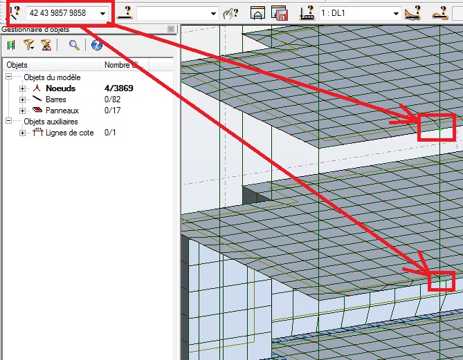

In this case - change solver onto Skyline ;
Create new case apply nodal load on direction given in warning message, after caclulations check displacement and rotations in this node
-> How is it possible to highlight the calculation node wich is going wrong?
In general this way starting from v 2014:
(In your model there is nothing wrong in this node - see above)
