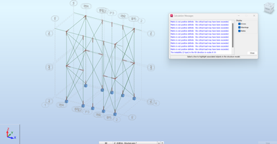

I have modelled a steel structure with user defined sections (as the section I need are not available in Robot). The structure is properly braced in both directions. But I need to model all connections as pin as they can not transfer moment. But I get so much error for instability (1, 2 and 3 type). is it ok to have such error? or is there away to fix it?
Attached is my model.
Thanks in advance

Hi @nali_ameen
Select all bracings and delete releases and set them as Truss.
select bras 16A19 and delete releases
Select all supports and set them as Fixed
Type 3 warning may be ignored
Model attached
M. Agayr

In reality my supports will behave as pin support and if I change it to pin, I get type 1 error. does that mean my structure is really unstable?
also, sorry, I didn't understand the 2nd point "select bras 16A19 and delete releases".
Thank you.
Message 4 of 11
Simau
@nali_ameen
Sorry for typo, i mean bars or members  16 to 19
Setting suppports as fixed will not change results as your columns are released. It avoids instabilities

Hi @Simau,
I have made some changes in my model (considering also adjustments you mentioned previously). But now I see an error regarding conversion and type 2 warning:
Is there any workaround for that. Thank you

Simau
@nali_ameen
Modif made:
Correct a geometric inaccurancy
Supports as fixed with columns released
Pinned-Pinned release set as xxxxff-xxxxff
Load cases 2 3 4 set as auxyliary
Nonlinear analyse parameter modified (see on the model)
Type 3 instability maybe ignored

Thank  you so much @Simau , really interesting. One question please, if I make the columns pin-pin, I get a warning for "Matrix is not positive definite". Does this warning has any relation to stability of my structure?
Thank you.

Take in mind that columns are not pin-pin, but pinned at the bottom and fixed at top.
Look at my previous model

Thank you @Simau, but in reality my connections between the columns and the beam is pin connection. Why would this make an error in Robot?
Message 11 of 11
Simau
@nali_ameen
You may use this for the columns
