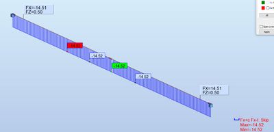

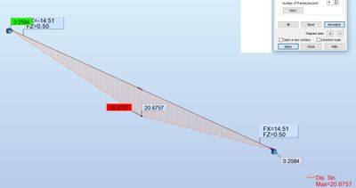

I have been studying this case  andwith a few modifications
Let me guess .
For a 20kip prestress ,vertical deformation at midspan will be 12.16 in and normal force will be -24.68kip ???
and yes,  for the original case (prestress =1kip) , deformation is 20.68 in and normal force is 14.52kip.

Ahhh that's great!  And I didn't get to tell you that you do have a good sense of humor!  You'll probably be pleased to know that I too have been doing research - in my case it was searching for an existing post on this topic per your recommendation (I didn't find one so here we are).
Yes, that's the correct solution.  It's a rather easy problem to solve by hand and one of my favorite "go to" problems when trying a new software (yes, I actually have favorite problems :).  I rather like it for the hanc-calc aspect and you might be surprised how many programs have trouble with this (I'm not impressed with 80 nodes but that's a different discussion).  I'd be pleased to share with you the exact solution if you like (i.e., the general equation) but it seems you may already have it or probably just solved it yourself.  Just let me know.
