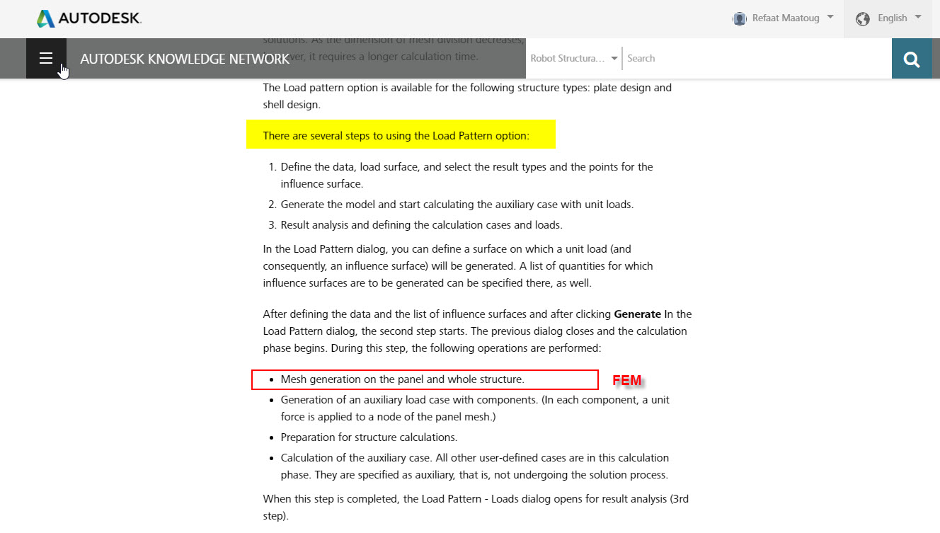

I have recently been experimenting with the load pattern feature in Robot.
Unfortunately, I am struggling to generate the maps/results (see attached screenshot) - is there a step by step tutorial/video available?
Can load patterns be applied to cladding elements? What am i missing?

Thanks Refaat
I did see that previous thread, but didn't know why there was no option to display the maps.
I have re-run the analysis using a slab instead of a cladding, and it seems to work fine. I guess you have to model a FEA panel, not a cladding...
Refaat
Yes , FEM
