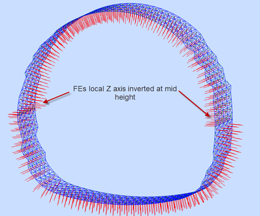

Rafacascudo
In fact,maps displayed obbey to the FEs local system which generally agree with the parent panel local system . But ,strangely for me , that is not what happens in your model. FEs local system of Botton part agrees with the panel local Z(outwards) while in the upper part FEs local Z is pointing inwards.And yes , I am talking about the model where it points outwards all around.
Tried to fix it but I was not able to.
I noticed you used the solid modeler , which I never use. Maybe official autodesk support can help you further
