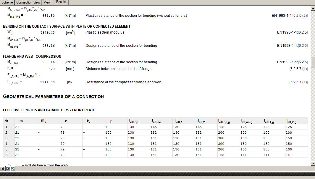

As you know, calculation report of steel connection is very detail and quite long. So how can i check the result correct or not? Let show me your experience, would you create a spread sheet to compare with Rsap report, or any diffrent way can be?

You should know about the Eurocode then refer to the formula number marked in the calculation for your own checking.
It is meaningless if you do not have any idea about the design code.
