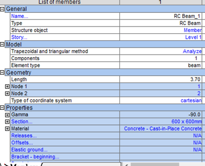

for example,
1) I want to get the "Node 1" and "Node 2" through the api
2) I want to get the length of the beam

HI @wllao
two ways (by bar, by node)
Sub GetBarLength()
  Dim RobApp As IRobotApplication: Set RobApp = New RobotApplication
  Dim Structure As RobotStructure: Set Structure = RobApp.Project.Structure
  BarNo = 1 'Example: Barre number 1
  Dim Bar As RobotBar: Set Bar = Structure.Bars.Get(BarNo)
  'First Method
  BarLength1 = Bar.Length
  'Second Method
  Dim N1 As RobotNode, N2 As RobotNode
  With Structure.Nodes: Set N1 = .Get(Bar.StartNode): Set N2 = .Get(Bar.EndNode): End With
  DX = N1.X - N2.X: DY = N1.Y - N2.Y: DZ = N1.Z - N2.Z
  BarLength2 = (DX * DX + DY * DY + DZ * DZ) ^ 0.5
  Debug.Print BarNo, BarLength1, BarLength2
  Set RobApp = Nothing
End Sub
Best Regards
Stéphane Kapetanovic
