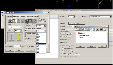

Is it possible to use a steel hollow section as the beam member when designing a column-beam connection in Robot Structural Analysis 2012 Pro?
According to online user guide (link below), hollow sections seem to only be available for column members of base connections.
http://docs.autodesk.com/RSA/2012/ENU/filesROBOT/GUID-435C42C0-C4E8-4970-B78E-A52E21B08C6-1058.htm

No, this is not possible. The easiest way of checking the available section types for particular connection is to check which of the parametric section icons are not grayed out as shown on the attached picture.

I am interested in designing a steel connection with a double H profile. It's for a base column.
I don't have it available on robot, i can only design a I profile or a tube.
Neither the user defined compound won't work.
What should i do ?
Thank you

I need to calculate a base plate for a steel column a double HEB
It is not availabe in the section selection.
Is there any possibility to have this calcul done ?

With such section not being supported you may try to use the user defined structural tube and stiffeners instead if this is acceptable for you.

I am looking for connection design for HSS column to W section BEam. However in the Robot I am not able to find the HSS section for column. I have attached screen shot of the database for columns available in Robot . So can you please help me out

For this connection type structural tubes are not supported.

You can use structural tubes as profiles for beams and columns but they are not supported for the connection type you would like to use.

Apparently I haven't managed to state that clearly enough. You can use both types of profiles in the model (see the attached picture) but structural tubes (HSS) are not supported in the connection module of Robot for beam to column web connection so you cannot select them from the connection definition dialog.
