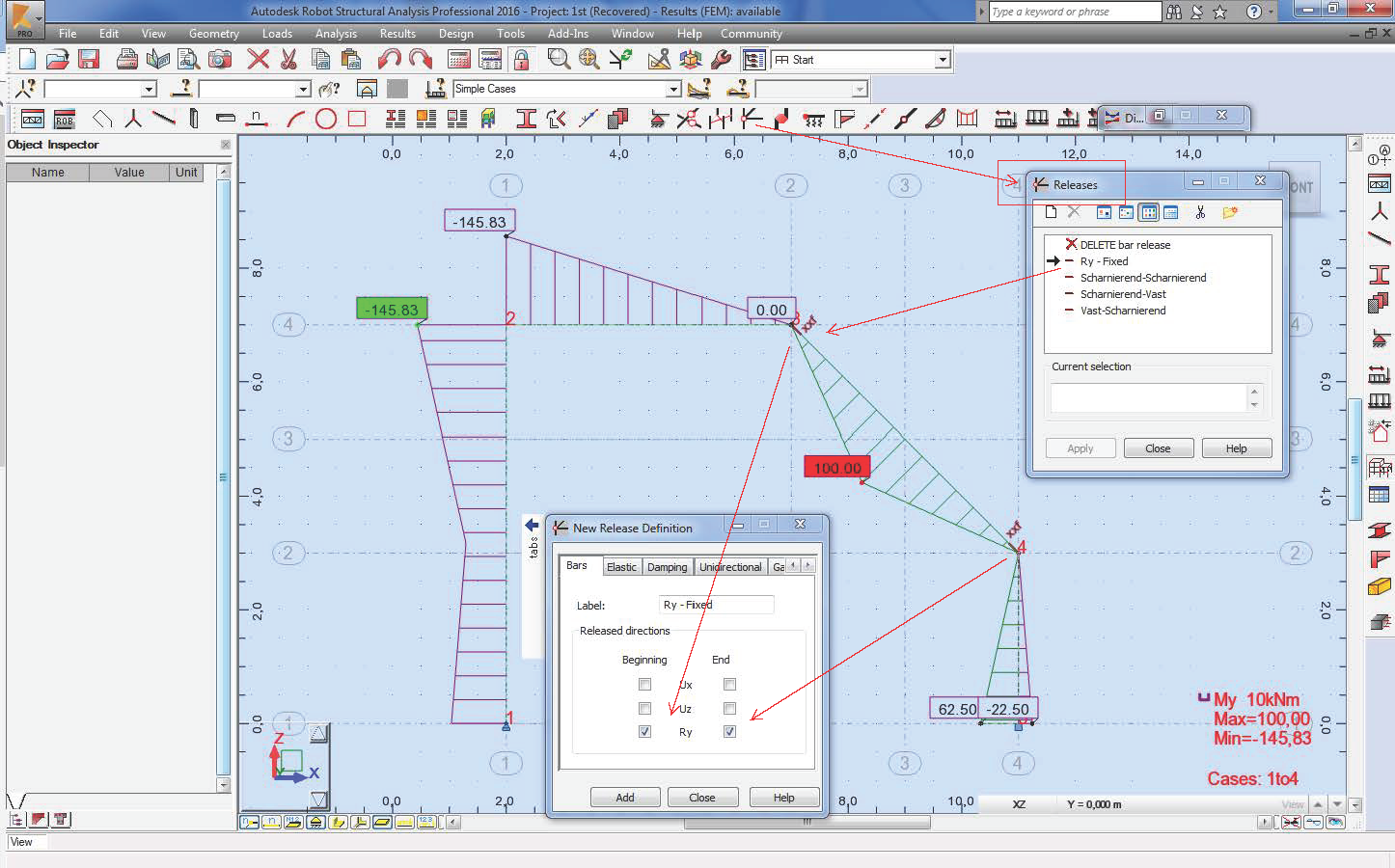

Moment in joint no.3 should be zero, but it is not. Can someone, please, be so kind to show or explain how to model that hinge joint correctly ?

Hai Filip,
You can make hinge on bars by clicking 'releases'
See screen.
