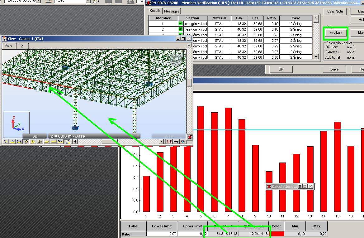

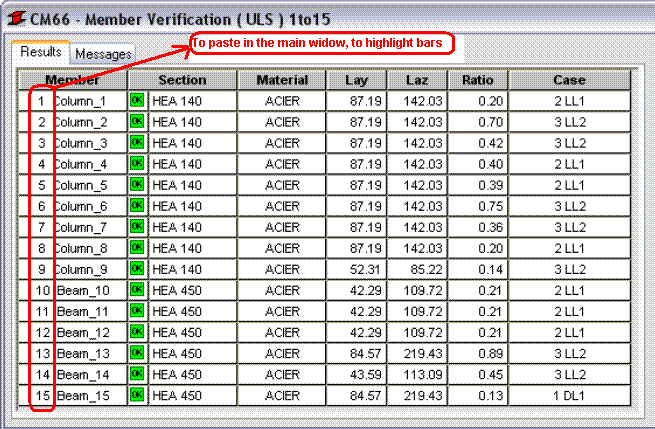

how can I do to select bar number and paste them in teh main window, as in the example below

Try Global Analysis - Bars

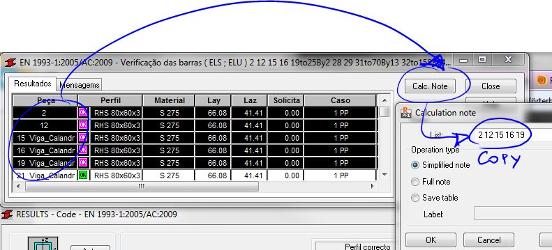

It's possible if you select the desired bars and click "Calc Note" make like example below:

The two methods work well. The 2nd is faster.
Many thanks for help
