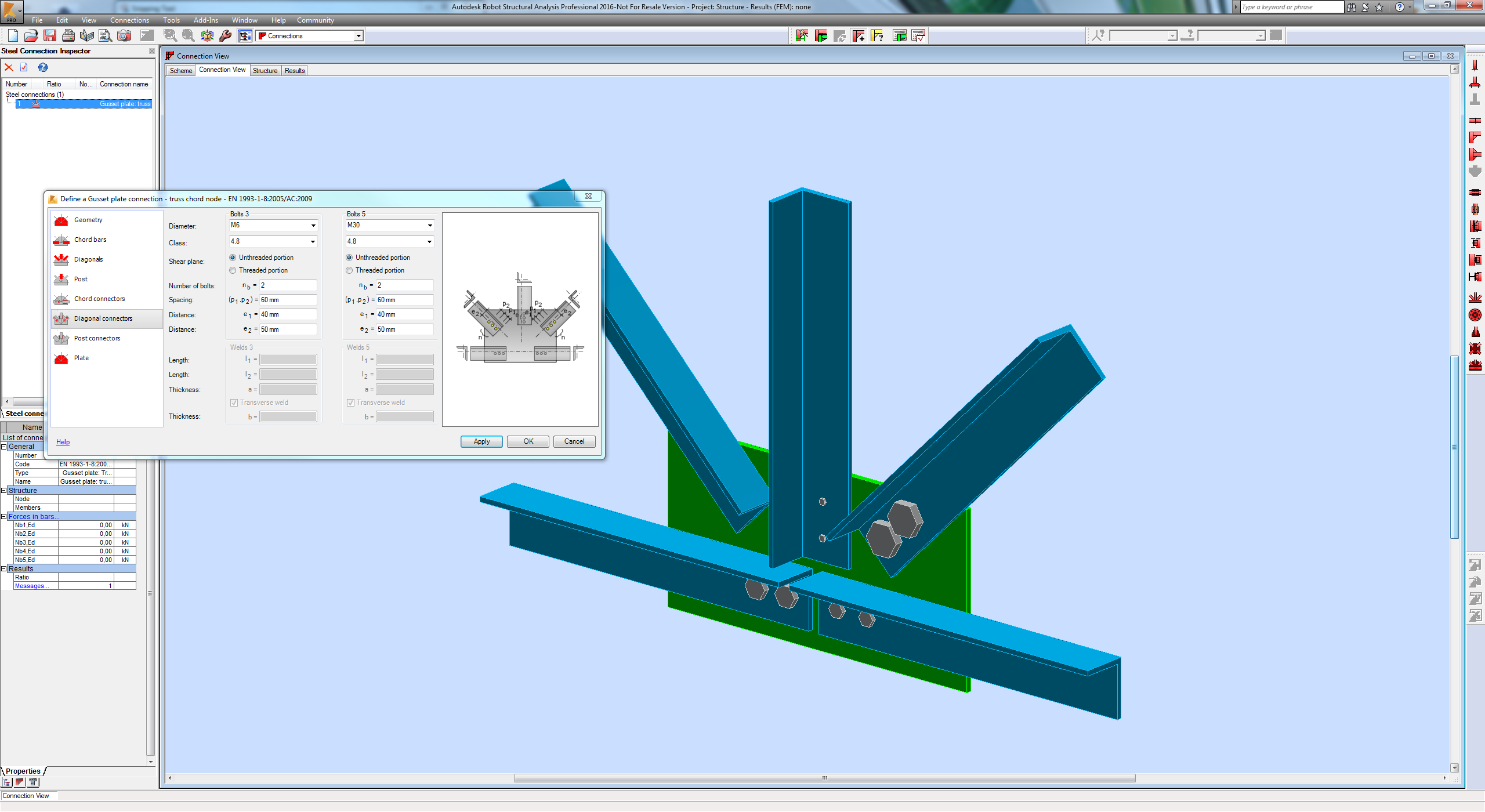

I am not able to choose a bolt diameter . Any value I choose, it always calculate the connection with 16mm bolts.

Is it for any file or a specific one? Do you have the bolt database declared in Job Preferences?

It can be from a model or a generic with manual calculation.
yes, astm imperial and metric(favorite) are declared but bolts appear only on imperial units

Could you send me the rtd file with such connection please? Thank you.

File attached. Not a real structure. Just a test.

Please use EN bolts

It worked!
Thx Artur!Smiley (fröhlich)
