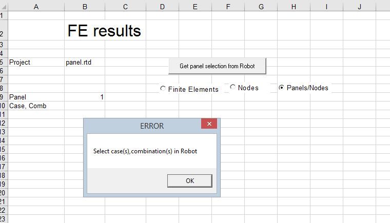

in reply to: Rafal.Gaweda
Every time I get the same error "Select case(s), combinations(s) in robot.
What I have to do? I put case in B10 cell but still doesn0t work
Message 44 of 75
