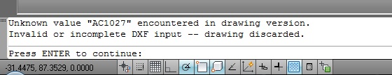

Hello! I am trying to export a 3D structure from Robot to AutoCAD (3D drawing), but I can't do it successfully.
I go to the "File - Save As" and then I choose the file saving format (I tried to save in .dwg and .dxf). The CAD file was generated, but when I open it there is an error and nothing appears (image 1).
There is something wrong in my "saving" procedure?
Many thanks.

What is your version of AutoCAD? Is it 2013 (AC1027)?

My AutoCAD's version is 2011. A colleague of mine is having the same problem and he has the AutoCAD 2012 version.
We tried to make this operation in earlier robot models (Robot 2012), and we were able to do it; the file dwg/dxf was created from robot and functioned well in AutoCAD.

Robot saves dwg/dxf files in their latests formats. The format of dwg/dxf from v.2013 of AutoCAD is different than the ones from 2010-2012 versions. You can see this information when you open dwg file saved from Robot 2013 in e.g. AutoCAD 2012.

Ok. But the colleague that I mentioned before has AutoCAD 2012 version and Robot 2013, and he was unable to open the dxf/dwg file too.
So the only way is to open the CAD file created by Robot 2013, with the AutoCAD 2013?
Yes. The reason is that AutoCAD 2012 cannot open dwg/dxf files saved in dwg/dxf 2013 format.
