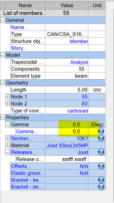

Hello, I have the following error, when I want to generate frames automatically with the "frame generator" plugin and when I place in purlins a joist property, when calculating it tells me "not allowed attribute defined for a joist".

You have to change section rotation Gamma angle to zero.
In Frame Generator, by default purlins section is rotated to be perpendicular to the sloped roof.  It is not allowed to rotate joist sections.

thanks, this solution is correct.
