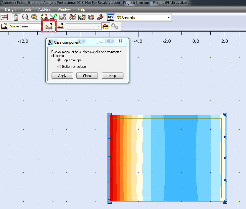

In a floor plate model using panels I'm trying to read the bending moment from an envelope defined as above using Results/Maps. Is it possible to seperate the Min/Max results from the envelope so the contour plots become useful.
Case 1: Plot Envelope_Max
Case 2: Plot Envelope_Min
I'm aware it can be done by manually modifying the contour limits under "scale", but this easily become quite time consuming and I'm sure there's a way of isolating the max/min effects?

There is the devoted option for this:
