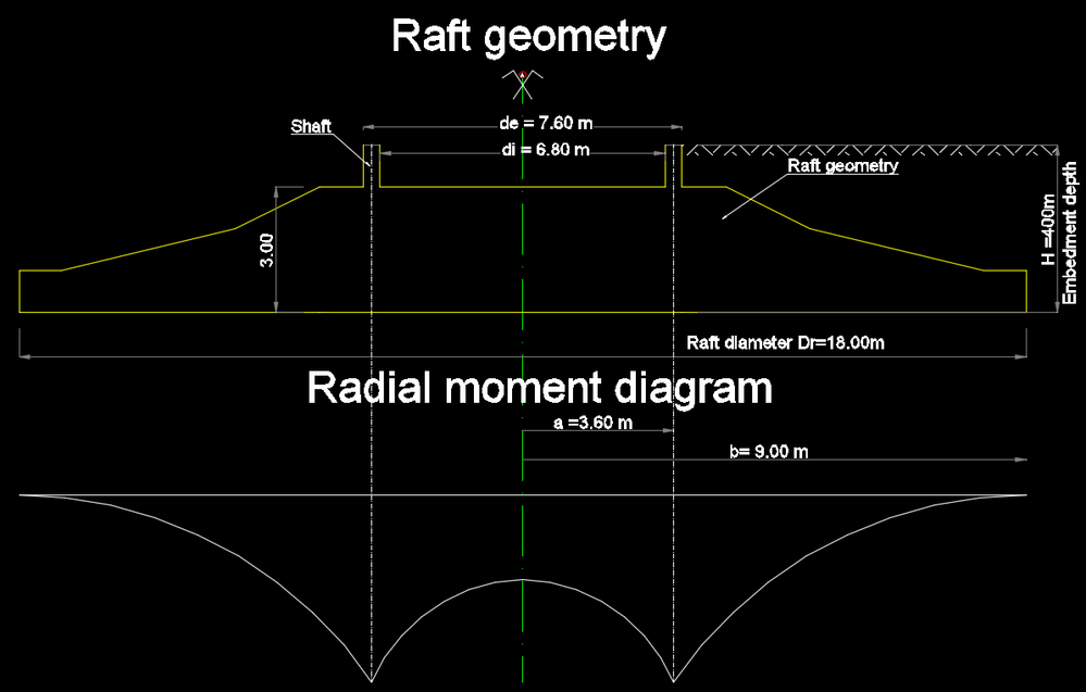

Getting to the heart of the matter: as you can see in the table below, I grouped the sums of reactions for the maximum combinations in order to design the raft foundation, where:
  • for vertical force FZ:  maximum is for case N°6 (ELU) and N°7 (ELS).
  • for Horizontal force FX and bending moment MY: maximum is for case N°13 (sismic)
To determine the radial and tangential moments acting at the base of the raft, I used Timoshenko’s theory for circular plates, as described in the extract document below, where the bending moments resulting from the two load cases discussed must be summed:
  • case n°1: represents the soil pressure acting in the +Z direction.
  • case n°2: represents a linear vertical load coming from the shaft and acting in the −Z direction.
In my case, and for the application shown in the image below, I defined "a" as the intermediate radius of the shaft and "b" as the raft radius. Thus, I have:
  • a = 3.60 m
  • b = 9.00 m (after calculating the raft diameter by checking the overturning moment condition)
The total radial moment diagram (Case 1 + Case 2) should match the diagram shown in the image above. However, when I run the attached file below, I obtain an incorrect diagram, as shown below, and I dont know where I was wrong ?
Edit:
Please check the rtd file + hand calculations
Thanks.

Hi @REDO10
The way you modeled the raft is not correct. The raft is not supported on its circumference; it is a slab on elastic supports.
You may design your raft using Robot and without hand calculation
You can transfer the reactions from your main model (source file) to the raft (target file) using this API.
https://forums.autodesk.com/t5/robot-structural-analysis-forum/only-reaction-for-new-model-api/m-p/3...
