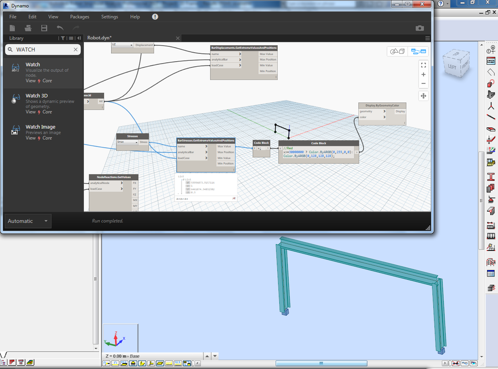

Dear Mr. Kosakowski
Thank you so much for all your helps till now. To highlight those bars in Robot whose stresses exceed a value, I wrote a code in Dynamo but it didn't work. I attached its photo as well as its original Dynamo file. Could you please help me to highlight those bars whose stress exceeds the specified value to red (that is 30000000 here). Could you please help me? I already asked in Dynamo Forum but no body has replied me.Dynamo Robot.png
I also attach its dynamo file
_ew
Dear Mr. Valinejad,
To highlight an element in Dynamo UI, you need to pass to the node Display.ByGeometryColor a Dynamo geometrical object. In your case this is a line.
To achieve our goal you may need to use different results nodes to be able to map lines and analytical bars objects.
The structural analysis package for Dynamo is a labs product and the best is to ask questions related to the package in this forum  . For general  Dynamo questions, the best place is http://dynamobim.org/forums/

Thank u so much. I don't exactly know how to do it. Could you please show me on my Dynamo file? Thank u so much
