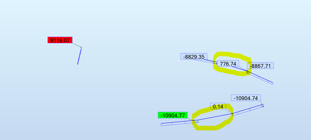

Hi there,
I have a 'K' frame which has been designed so in theory the central strut restrains the incline in one direction (the main 45 degree incline), and the outer ties restrain the incline in the other direction (11.72 degrees from vertical) (see screenshot). The only thing is, the Robot model does not use the central strut, meaning the entire tie force from both inclines is being transferred through the two outer 'ties'.
This causes infinite displacements as the outer ties have not been designed to restrain that amount of load. Can anyone advise what can be done to model this accurately?
By the way, the axial load applied at the top of each column is 18MN and the vertical elements are SHS600x600x50 and horizontal elements are SHS500x500x36.

Hi @shannon.lloyd
Frame was statically instable
I have changed releases and support system to calculate it
See attached model
Let me know if you have any comments
Krzysztof Wasik

shannon.lloyd
Thank you so much for your help, I really appreciate it. Looking through the new releases and supports you've made, it makes sense now.
However the inner strut on each of the 3x K-frames is still taking barely any load when they should be taking 18MN * sin30 / sin(90-30) = 10.39MN (I meant to say previously that the columns are inclined at 60 degrees, not 45 degrees, on the main incline).
I am hoping that the outer ties will only need to support the tie force of 18MN * sin11.72 / sin(90-11.72) =  = 3.73MN (I know this is the force pushing out from the centre of the whole structure, which I then resolve to find the axial tie force in the outer ties).
To get around this, is there a way I can set a limit on the axial load a bar can transfer? Sorry if this is confusing!
Thanks again for your help,

Hi @shannon.lloyd
Strut axial forces are about between 18 and 20 Mn
see screenshot
Horizontal takes between 8 and 10 MN (except of marked connectors)
It seems to be reasonable. Since you have not defined horizontal forces it makes sense.
You should go through steel dimension procedure to see elements capacity.

Hi @shannon.lloyd
Model is built with series of unstable systems
See below
unstable.PNG additionally
bar 3 has releases in all directions on both ends (it is not allowed)all.PNG
additionally columns
8to11 19 56
are unstable horizontally due to hinged connection in column center.
Releases and supports should be updated to remove static instability
