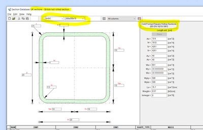

Hi @yiviw97057
Use SHSC 200x200x10 from UK section database.

Hi @yiviw97057
They are available in UKST and NS34 databases
Refer to Add section database to the project

Hi @yiviw97057
  1. Open Tools >Job Preferences>Databases >Steel and Timber sections
  2. Click Adding of new database to the list.
  3. Select database from drop down list.
  4. OK
  5. Ok in Job Preferences dialog to validata modification.
Refer to Help topic
